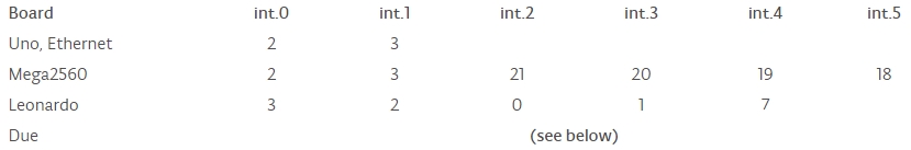

The GSM shield communicates with an attached Arduino through the Software Serial library. By default, communication between the modem and Arduino happens on digital pins 2 and 3. On the Uno this works without modification, but to use the Leonardo or Mega boards, some slight changes are required.
The GSM_TX pin, pin 2 on the shield, sends information to the Arduino. The Arduino relies on an interrupt to know when to read the information on this pin. The Leonardo and Mega do not have interrupt capabilities on pin 2.
You do not need to change any code to program the shield for use with the Mega or Leonardo, the library will change the Arduino's RX pin automatically depending on the board selected in the "Tools" menu of the IDE.
Arduino Mega
The GSM library uses digital pin 10 to communicate with the Mega. On the GSM shield, connect a jumper wire between digital pins 2 and 10.
Bend the male header attached to pin 2 on the GSM shield to the side so it does not connect with the Mega.

有點不明白, Uno 跟 Mega 在 pin 2,3 上的 interrupt 設定是一樣的, 只有 Leonardo 是不同.
為何在 uno 上沒問題, 在 Mega 上就不行呢?

发表于 2014-9-11 23:09:20 | 显示全部楼层
kevinzhang 发表于 2014-9-11 16:20
越听越糊涂了。。。。
因為它說:
但 digital pin 2 and 3, 在 Uno 及 Mega 是一樣的, 只是 Leonardo 有分別, 所以不明白為何 Uno works without modification, but for Mega, some slight change are required.
http://arduino.cc/en/Guide/GSMShieldLeonardoMega

這正是問題所在, 而非原因.....
pin 2 同 pin 3, 在 Uno 同 Mega 都係一樣的, 只係 Leonardo 有分別:
http://arduino.cc/en/Reference/AttachInterrupt
大家既 pin2 都有 interrupt, 只不過係  int.0 同 int.1 既分別.
如果話 Leonardo 唔同, 我無問題, 但係點解 Mega 明明同 Uno 一樣都唔得?  而要改用 pin 10?

Mega2560 的 PinMapping:
http://arduino.cc/en/Hacking/PinMapping2560
若用 http://arduino.cc/en/Reference/AttachInterrupt 的描述,當然是問題,因為它本身就是問題的所在。

唔好意思, 都仲係唔明..
跟據 GSM Sheild 講:
而 Uno 同 Mega 既 pin 2 同 3 都係會觸發 int.0 同 int.1 (而 Leonardo 就調轉左).
而佢又話:
我就更加唔明, Mega 既 digital pin 10 反而無 interrupt 既.....
可能有 D 野我理解錯左, 所以有點混亂, 唔知 ching 可唔可以直接少少謂解一下.

祇要實際看回電路圖和PinMapping,相信以下這個才是正確:
對於第10腳的疑惑,其實原作者亦已在文中說明了:
Arduino MegaThe GSM library uses digital pin 10 to communicate with the Mega. On the GSM shield, connect a jumper wire between digital pins 2 and 10.

oh, 即是說, arduino.cc 中, 對 mega 的 interrupt 描述有錯 (跟 pin mapping 不同)?
http://arduino.cc/en/Main/ArduinoBoardMega2560
External Interrupts: 2 (interrupt 0), 3 (interrupt 1), 18 (interrupt 5), 19 (interrupt 4), 20 (interrupt 3), and 21 (interrupt 2)
而 attachInterrupt 中的列表也是一致的, 我沒想過 pin mapping 並非如此.
因為我是根據它的描述去想的, 所以才不明白.  如果這裡有錯的話 (D2 跟 D3 並非對應 Int.0 及 Int.1), 那就可以解釋到為何跟 Uno 有分別了.
另外有關 digital pin 10....它的解釋有問題...因為 mega 的 D10 本身也沒有 INT 的...但 pin mapping 是 map 到 Int.4?
今晚回家用 mega 做個簡單測試, 就可以確認 Int.0 及 Int.1 對應 的 pin 是那個了.
